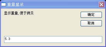

  1. ;;我写了<钢板重量计算器>http://www.xdcad.net/forum/thread-669968-1-1.html,为了显示重量,便于拷贝,写了
  2. ;;一个对话框,newer版主曰,用OpenDcl,可惜我不会。用下面的代码也倒是一个简单办法
  3. ;;示例(HH:InputBox "5.3")
  4. (defun HH:InputBox (weight / STR)
  5.   (setq str (VL-PRIN1-TO-STRING weight))
  6.   (setq str (strcat "dim ret \n ret=InputBox("显示重量,便于拷贝","重量显示"," str ") "))
  7.   (or *wscript*
  8.       (setq *wscript* (vlax-create-object "ScriptControl"))
  9.   )
  10.   (vlax-put *wscript* 'language "vbs")
  11.   (vlax-invoke-method *wscript* 'ExecuteStatement str)
  12.   (vlax-invoke-method *wscript* 'eval "ret")
  13. )

可以试试这个DosLib, 简单对话框不需要学蹩脚的DCL,复杂的ODCL
Command: (dos_getstring "Text" "Enter some text")
"This is a string of text"
