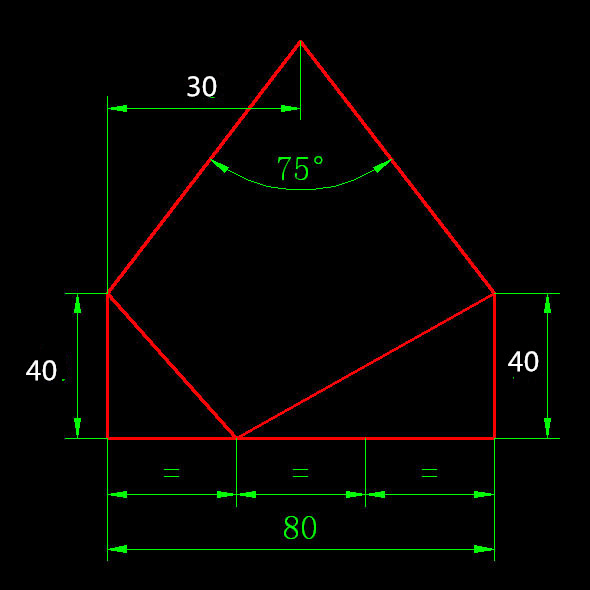

这个图怎么画,画图步骤~

发表于 2013-11-17 08:35:48 | 显示全部楼层
30的标注是不是错了,应该是40 吧

发表于 2013-11-17 08:53:41 | 显示全部楼层
用以下程序可得到近似解:
  1. (defun c:cc()
  2.      (setq cm (getvar "cmdecho")
  3.            os (getvar "osmode")
  4.      )
  5.      (setvar "cmdecho" 0) (setvar "osmode" 33)
  6.      (setq h1 30.0   h2 60.0
  7.            pp (/ pi 180.0)
  8.            njh (+ (* 75.0 pp) (atan (/ h1 30.0)) (atan (/ h2 50.0)))
  9.      )
  10.      (while (not (equal njh pi 1e-15))
  11.           (setq hm (/ (+ h1 h2) 2.0)
  12.                 njh (+ (* 75.0 pp) (atan (/ hm 30.0)) (atan (/ hm 50.0)))
  13.           )
  14.           (cond ((< njh pi) (setq h1 hm))
  15.                 ((> njh pi) (setq h2 hm))
  16.           )
  17.      )
  18.      (princ "\nhm=")(princ hm)
  19.      (if (setq p0 (getpoint "\n基准点:"))
  20.          (progn
  21.               (setq p1 (mapcar '+ p0 (list (/ 80.0 3.0) 0.0))
  22.                     p2 (mapcar '+ p0 (list (/ 80.0 1.0) 0.0))
  23.                     p3 (mapcar '+ p2 '(0.0 40.0))
  24.                     p4 (mapcar '+ P0 '(0.0 40.0))
  25.                     p5 (mapcar '+ p4 (list 30.0 hm))
  26.                     p6 (mapcar '+ p4 (list 15.0 (* 0.75 hm)))
  27.                     p7 (mapcar '+ p4 (list 30.0 (* 0.5 hm)))
  28.                     p8 (mapcar '+ p0 '(-10 20))
  29.                     p9 (mapcar '+ p0 '(40 -10))
  30.
  31.               )
  32.               (setvar "osmode" 0)
  33.               (command "_pline" p0 p2 p3 p1 p4 "c")
  34.               (command "_pline" p4 p5 p3 "")
  35.               (command "_dimlinear" p4 p5 p6)
  36.               (command "_dimangular" "" p5 p4 p3 p7)
  37.               (command "_dimlinear" p0 p4 p8)
  38.               (command "_dimlinear" p0 p2 p9)
  39.          )
  40.      )
  41.      (setvar "osmode" os) (setvar "cmdecho" cm)
  42.      (princ)
  43. )
 楼主| 发表于 2013-11-17 22:29:21 | 显示全部楼层
对的 就是这样,现在会了,用的是圆心角和圆周角把75度画出来的

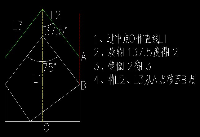

发表于 2013-11-22 02:06:03 | 显示全部楼层
画75度角不要这么复杂: 1.jpg
