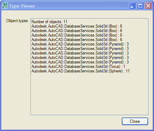

Here's what you get when you run the VT command and hover over a number of Solid3d objects:
You'll see that a number of "duplicate" objects listed... this is because we have multiple sub-objects under the cursor, each of which is listed passed into the event via a separate sub-entity path. We could easily remove duplicates from the list as we create it, or make better use of the path information to find out more about the sub-entities themselves.
