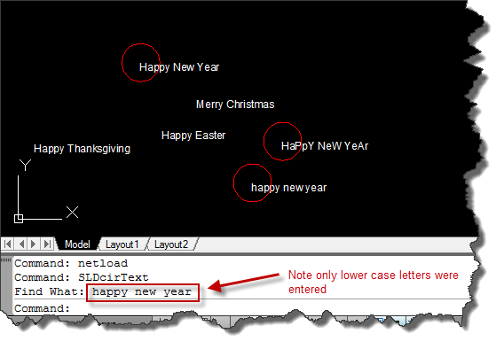

To test this build the solution and NETLOAD the .dll into AutoCAD. Place some MText objects in the drawing and then type in SLDcirText at the command line. You will be prompted to enter a string to search for. Enter a string and regardless of case the matching strings should be circled.
