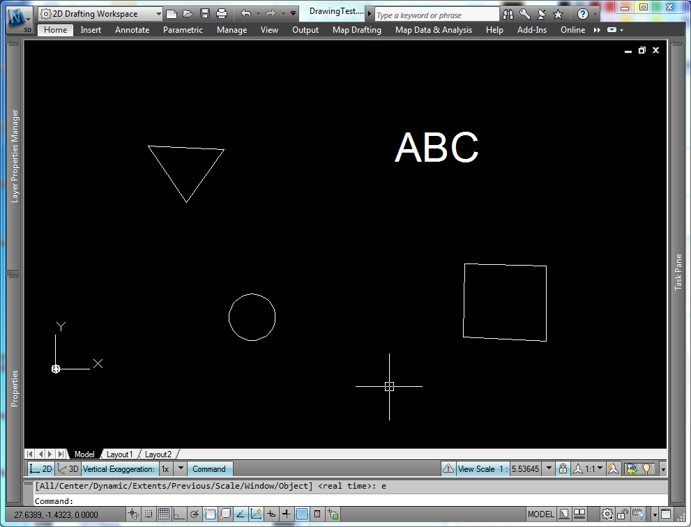

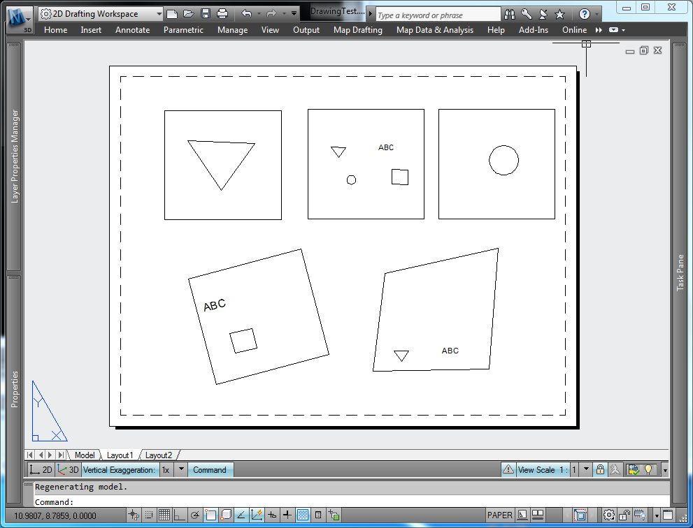

Selecting Entities In ModelSpace Through Viewport
Very often, we need to select entities in ModelSpace, which are visible in a given Viewport on a layout. That is, we want to project the viewport's boundary (as a rectangle, or as a non-rectangle polygon) into ModelSpace and find all entities inside, fully or partially.
In other case, given a point, or an entity, in ModelSpace, we may want to determine which viewport or viewports on a layer the point/entity can be seen.
Note: there is a post in Autodesk's user forum on this topic.
I began with code that collects Viewport information on a given layout. The information is used to determine which entities in ModelSpace are visible through each Viewport, and is collected in one single transaction. Here is the code:

Following picture shows the drawing I test the code against:
[url=http://drive-cad-with-code.blogspot.com/search?updated-min=2014-01-01T00:00:00-08:00&updated-max=2015-01-01T00:00:00-08:00&max-results=5]http://drive-cad-with-code.blogspot.com/search?updated-min=2014-01-01T00:00:00-08:00&updated-max=2015-01-01T00:00:00-08:00&max-results=5
