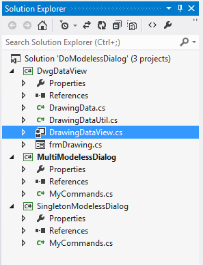

Here is the Visual Studio 2012 solution, which includes 3 projects:

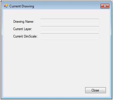

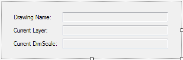

Project "DwgDataView" contains a Windows UserControl and Windows Form that can be used in AutoCAD addins:
This project also has a data model class and a AutoCAD utility class to get and hold drawing specific information.

Code of UserControl DrawingDataView:

Code of Form frmDrawing:
