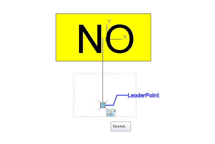

In drafting process, often user needs to create something like a label with a leader and points it to something in the drawing. The picture below is an example.
Also more often than not, depending on how crowded the drawing content is, user needs to move the label around. It would be better that when the label (be it consists of separate entities, or a block) moves, its pointing leader's tip can remain where it was, so that user would not have to move the label and then re-points the leader.
When I ran into a similar requirement from one of my AutoCAD programming project, the first idea jump out from my head is Overrule. For example, the label can be just a block without a leader line. Then I could use DrawableOverrule to draw a leader as the visual effect.
The problem with this approach is that the Overrule code must be loaded and enabled all the time. Or the label would not appear to have a leader pointing the point in interest.
In my real project, we settled with using a dynamic block for the label, which has a stretchable leader. Following is an example of a similar block:
Here is the [url=http://screencast.com/t/G4b39d4qRzn]video clip
that shows how its leader can be stretched freely. The advantage of using this kind of block is that even if the code to auto-points the leader is not loaded and/does not works, the user can always manually drag the leader to make it point to where it is supposed to.
With this block, I figured, as long as I know where the point of interest, to which the leader points, I can always set the dynamic property's value (the X/Y value of the point parameter, named as "LeaderPoint" in this particular block).
So, the logic of setting the point parameter value is really simple: When the label block is inserted, the point of interest is saved with this block as XData, and then whenever the label block is changed (moved, stretched, rotated, scaled), the point parameter's value is recalculated and reset, thus the leader will remain pointing to the point of interest.
I went ahead trying to implement a TransformOverrule, thinking it would be fairly easy to do with just creating the overridden TransformBy() virtual method.
However, it turned out that the TransformOverrule was not the solution for 2 reasons:
1. The TransformBy() method seems not being triggered when user moves the block by select the block and drag the block by its grips;
2. AutoCAD crashes when the code is trying to set block reference's dynamic property value in the TransformBy() method. The crash is not not catch-able in my "try...catch..." code block, and if the code does not try to set the dynamic property value, then no crash. I just could not get over with this crashing issue and tend to think it is something inside the API, be it a bug or not.
The other drawback with using Overrule is, as I stated previously, the Overrule code has to be loaded all the time.
Therefore I gave up the Overrule idea and turned to handling events, like CommandWillStart, CommandEnded, and ObjectModified. The idea is that during the period from CommandWillStart to CommandEnded, the code will watch ObjectModified event if the command results in changes to the specific block references. The changed block reference's ObjectId is saved in a collection. After CommandEnded event, if the collection has ObjectId in it, extra code is executed to reset the block reference's dynamic property value (the point parameter that stretches the leader).

Below is the code that insert the label block and enable the AutoPointingHandler. Note the the command methods are NOT static, so the command class is instantiated for each document when the commands is executed. This way, the AutoPointingHandler instance only hooks to events of its own drawing document.

Watch this video clip to see the code in action.
A few things to note:
1. During the select-first operation of moving/rotating/scaling, the grip for dragging the leader's end point is not updated until the label block is deselected. I tried in code with Editor.Regen() without success. I could have try to remove it from the implied SelectionSet, but figured it is not a big deal.
2. While the AutoPointingHandler is enabled, when user drags the dynamic block's leader to point it to somewhere else, the leader will always go back. This could be good thing or bad thing. But in my case, this is by design, a good thing.
3. The key factor for this to work is to embed the point of interest with the block reference. If the point is changed, the block has to be re-inserted in order to have the changed point to be embedded with the block as XData

需要一个有 拉伸点 特性的 动态块,另外需要建立 layer1 图层(图块所在层),在2014上编号实现了,但是这个拉伸点没有成功,可能中文版这个特性名称不对
