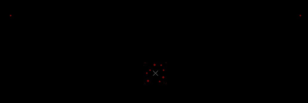

 楼主| 发表于 2014-8-14 09:45:41 | 显示全部楼层
谢,非常好,特别感谢!另外还想麻烦一下ZXQ0220;帮我修改一下这程序现在程序是(转出去的坐标都OK,只是有一点,转文件时每一种圆的直径都需要手动输入,想麻烦ZXQ0220帮我修改成,有个选择1.回车或鼠标右键默认大小,2.手动加大。现在程序就是手动加大,我就想加一个默认的,不用改,就怕有十几种全部都去输入一次,有点浪费时间!谢谢)
(defun c:cnc()
(PRINC "\n请选要输出的圆[提示:不要的层最好关闭]")
(setvar "CMDECHO" 0)
(if (setq ss (ssget '((0 . "CIRCLE")))) (progn
  (command ".UNDO" "BE")
  (setq i -1  cirlst (list))
  (repeat (sslength ss)
   (setq r (cdr (assoc 40 (entget (setq en (ssname ss (setq i (1+ i))))))))
   (if (assoc r cirlst)
(setq cirlst (subst (cons r (1+ (cdr (assoc r cirlst)))) (assoc r cirlst) cirlst))
    (setq cirlst (cons (cons r 1) cirlst))
  (setq i -1 cirlst (reverse cirlst) cclist (list))
  (setq cirlst (vl-sort cirlst (function (lambda (e1 e2) (> (car e1) (car e2))))))
  (repeat (length cirlst)
   (setq r (car (nth (setq i (1+ i)) cirlst)))
   (command "select" ss "")
   (setq ss1 (ssget "P" (list (cons 0 "CIRCLE") (cons 40 r))))
   (setq r1 (getdist (strcat "\n输入新直径<" (rtos (+ r r) 2 2) "> :")))
   (setq r (if r1 (* r1 0.5) r))
   (setq j 0 clist (list r))
   (repeat (sslength ss1)
    (setq ent (entget(ssname ss1 j)))
(setq j (1+ j))
(setq pc (cdr(assoc 10 ent)))
(setq clist (append clist (list (list (car pc) (cadr pc)))))
   (setq cclist (cons clist cclist))
  (setq nm (if nm nm ""))
  (if (setq nm (getfiled "输出钻孔文件的目录" nm "rot" 1)) (progn
   (setq i 0)
   (setq fp (open nm "w"))
   (princ "M48\nMETRIC,LZ\nVER,1\nFMAT,2\n" fp)
   (repeat (length cclist)
    (setq r (car(nth i cclist)))
    (setq i (1+ i))
    (princ (strcat "T" (if (< i 10) "0" "") (itoa i) "C" (rtos (+ r r) 2 3) "F42B423S6H2000\n") fp)
   (princ "DETECT,ON\nATC,ON\n%\n" fp)
   (setq i 0)
    (setq clist (nth i cclist) i (1+ i))
(princ (strcat "T" (if (< i 10) "0" "") (itoa i) "\n") fp)
(setq j 0 clist (cdr clist))
(repeat (length clist)
  (setq pc (nth j clist) j (1+ j))
  (princ (strcat "X" (rtos (car pc) 2 3) "Y" (rtos (cadr pc) 2 3) "\n") fp)
   (princ "M30\n" fp)
   (close fp)
  (command ".UNDO" "E")
(setvar "CMDECHO" 1)
(princ)

[attachimg]9384[/attachimg][attachimg]9385[/attachimg] 这样变形的,是错的。 右边这图是CAD输出的坐标, 看左边的图形就能看到变形了,左右两边两个圆坐标。  详情 回复 发表于 2014-8-16 16:59

还有你能帮我检查一下这代码,有时输出的坐标数据变形(意思是本身圆的坐标在23,25而变成100,320了)不是每个图形都是,有时十个图形有一个是,有时十个一个都没事
已领礼包: 60个
 楼主| 发表于 2014-8-16 16:59:20 | 显示全部楼层
