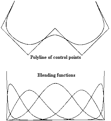

Since the knot spacing could be nonuniform, the B-splines are no longer the same for each interval [t_i, t_i+1) and the degree of the B-Spline can vary [WATT][FOLEY]. Considering the whole range of parameter values represented by the knot vector, the different B-splines build up continuous (overlapping) blending functions N_i,k(u), as defined in (2), over this range (Fig. 1) [WATT]. These blending functions have the following properties: [WATT][ROGERS]
Fig. 1: Cubic NURBS curve with associated blending functions.A NURBS-surface is define in a similar way:

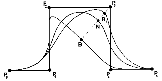

The Weights
As mentioned above, changing the weight w_i of a control point P_i affects only the range [t_i, t_i+k+1) (in case of a curve). The geometric meaning of the weights is shown as follows (Fig. 2) [PEIGL][ROGERS].Defining the points:
Fig. 2:
Geometric meaning of weights (w_3).
N and B_i can also be expressed as:
                N = (1 - a) * B + a * P_i                B_i = (1 - b) * B + b * P_i ,where                a = R_i,k(u; w_i = 1)                b = R_i,k(u).The following identity is obtained from the expression of a and b:
        (1 - a)/a : (1 - b)/b = P_iN/BN : P_iB_i/BB_i = w_i ,which is called the cross- or double ratio of the four points P_i, B, N, B_i. From these expressions, the effect of shape modification can be derived:
  • B_i sweeps out on a straight line segment
  • if w_i = 0 then P_i has no effect on shape
  • if w_i increases, so b and the curve is pulled toward P_i and pushed away from P_j, for j not= i
  • if w_i decreases, so b and the curve is pushed away from P_i and pulled toward P_j, for j not= i
  • if w_i -> infinity then b -> 1 and B_i -> P_i, if u in [t_i, t_i+k+1)
