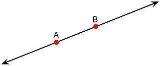

The Line Type Line type, which is a 1 dimensional entity of infinite length that is described by two points within its present dimension.
template <typename T, unsigned int Dimension>class line : public geometric_entity {};

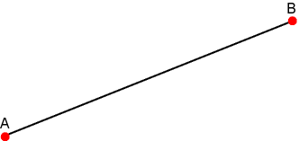

The Segment (Line-Segment) Type Segment type, similar to the line type, but is of finite length bounded by the two points which describe it within its present dimension.
template <typename T, unsigned int Dimension>class segment : public geometric_entity {};

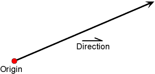

The Ray Type Ray type, A directed half-infinite line or half-line. A ray has an origin point and a vector that describes the direction in which all the points that are members of the set of points that make up the ray exist upon.
template <typename T, unsigned int Dimension>class ray : public geometric_entity {};

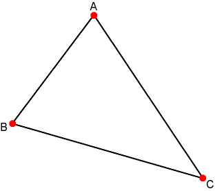

The Triangle Type Triangle type, A geometric primitive that is comprised of 3 unique points, which produce 3 unique edges.
template <typename T, unsigned int Dimension>class triangle : public geometric_entity {};
