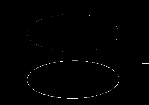

基于点集最小面积矩形的椭圆模拟,
  1. (defun ff (pts / box ptl p1 p3 p9 p7)
  2.   (setq box (apply 'xdrx_points_minareabox pts))
  3.   (mapcar 'set '(p1 p3 p9 p7) box)
  4.   (list (xdrx_line_midp p1 p9) (xdrx_line_midp p3 p9) (xdrx_line_midp p7 p9))
  5. )
  6. (defun c:test (/ ss pts)
  7.   (if (setq ss (ssget '((0 . "point"))))
  8.     (progn
  9.       (setq pts (ff (mapcar '(lambda (x) (xdrx_getpropertyvalue x "position")) (xdrx_pickset->ents ss))))
  10.       (vl-cmdf ".ellipse" "c" "_none" (car pts) "_none" (cadr pts) "_none" (last pts))
  11.     )
  12.   )
  13.   (princ)
  14. )

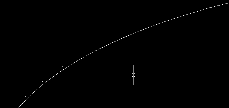

发表于 2016-6-11 20:06:10 | 显示全部楼层
测试了下,总体不错,细节还是有些点落在了外面。 测试点是在实际的椭圆上样本点。
