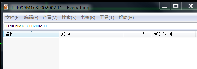

网友panliang9@sohu.com(2259433769)发给了我Everything,试了一下,速度相当快我用了sendkeys 自动拾取文本,但存在一个问题,如果中文或者带有特殊符号就不行,各位高手可有更好办法?

 楼主| 发表于 2016-11-8 07:49:31 | 显示全部楼层
(defun sendkeys        (keys)
  (or *WSH* (setq *WSH* (vlax-get-or-create-object "wscript.shell")))
  (vlax-invoke-method *WSH* 'sendkeys keys)
  (princ)
(defun C:SS (/ TXT)
  (if (setq txt (cdr (assoc 1 (entget (car (nentsel "\n 搜索文件,拾取文本"))))))
    (progn
      (SET-CLIP-STRING txt)
      (if (= (getenv "PROCESSOR_ARCHITECTURE") "x86")            ;32位
        (Everything32 TXT)
        (Everything64 TXT)
  (princ)
(princ "\n 搜索文件 SS")
(defun Everything64 (TXT)
  (startapp "Everything-1.4.1.773b.x64-Setup.exe")
  (sendkeys "^V")
(defun Everything32 (TXT)
  (startapp "Everything1.3.4.686.x86.x64.exe")
  (sendkeys "^V")
回复 支持 1 反对 0
