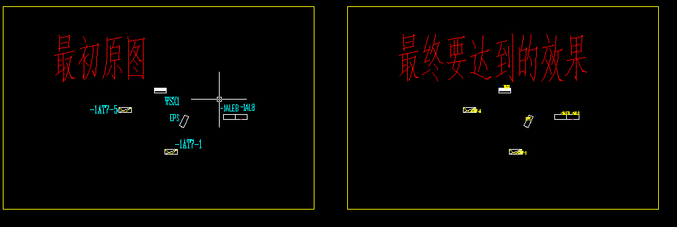

将一张图纸上的特定文字全部选择出来如前缀为-1   eps   ws   m    r等,用黄色显示,然后已图块插入点为中心指定一个范围如周边xxxxmm之内的黄色文字,满足要求的文字移动在图块中心点或者插入点上.

请合理确定范围,可以多操作几次完成, 相邻的图块分两次处理(一次处理不保证正确)
  1. (defun c:tt (/ ss str code1 dis ss lst blk txt)
  2.   (if (and (setq str (getstring "\n文字前缀(以逗号分隔): "))
  3.            (setq code1 (xdrx_string_replace str "," "*,"))
  4.       )
  5.     (while (and
  6.              (setq dis (getdist "\n输入范围: "))
  7.              (setq ss (ssget (list '(-4 . "<or")
  8.                                    (cons 1 (strcase code1))
  9.                                    '(0 . "insert")
  10.                                    '(-4 . "or>")
  11.                              )
  12.                       )
  13.              )
  14.            )
  15.       (progn
  16.         (setq lst (mapcar '(lambda (x)
  17.                              (reverse (cons x (xdrx_getpropertyvalue x "isa" "position"))
  18.                              )
  19.                            )
  20.                           (xdrx_pickset->ents ss)
  21.                   )
  22.               lst (xd::list:groupbyindex lst dis)
  23.         )
  24.         (foreach x (mapcar 'cdr lst)
  25.           (if (and (setq blk (cadr (assoc "AcDbBlockReference" x)))
  26.                    (setq txt (cadr (assoc "AcDbText" x)))
  27.               )
  28.             (xdrx_setpropertyvalue
  29.               txt
  30.               "position"
  31.               (xdrx_getpropertyvalue blk "position")
  32.               "color"
  33.               2
  34.             )
  35.           )
  36.         )
  37.       )
  38.     )
  39.   )
  40.   (princ)
  41. )
