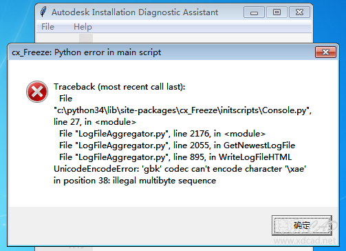

安装CAD2020版时,无法安装。
用Autodesk Installation Diagnostic Assistant 分析得出的错误问题所在
发表于 2019-4-1 14:31:17 | 显示全部楼层
怎么python34都出来了?
win7_64bit系统  详情 回复 发表于 2019-4-1 16:15

 楼主| 发表于 2019-4-1 16:15:57 | 显示全部楼层
Lisphk 发表于 2019-4-1 14:31
怎么python34都出来了?
win7_64bit系统

 楼主| 发表于 2019-4-2 16:17:57 | 显示全部楼层

2019/4/1:17:33:06        Administrator        WIN-20190228UJQ        AnalyzeInstallFailure() for log file: C:\Users\ADMINI~1\AppData\Local\Temp\Autodesk AutoCAD 2020 Private Install.log
2019/4/1:17:33:06        Administrator        WIN-20190228UJQ        AnalyzeInstallFailure() GetErrorontext returned: Error Context 1: 5 2:  3: 0
CustomAction licIsSvcUpgraded.8B858D99_2C63_4281_AE43_6782314CCC1B returned actual error code 1603 (note this may not be 100% accurate if translation happened inside sandbox)
MSI (s) (C8:04) [17:32:58:877]: Machine policy value 'DisableRollback' is 0
MSI (s) (C8:04) [17:32:58:877]: Note: 1: 1402 2: HKEY_LOCAL_MACHINE\Software\Microsoft\Windows\CurrentVersion\Installer\Rollback\Scripts 3: 2
Action ended 17:32:58: licIsSvcUpgraded.8B858D99_2C63_4281_AE43_6782314CCC1B. Return value 3.
MSI (s) (C8:04) [17:32:58:877]: No System Restore sequence number for this installation.
MSI (s) (C8:04) [17:32:58:877]: Unlocking Server
2019/4/1:17:33:06        Administrator        WIN-20190228UJQ        AnalyzeInstallFailure() GetErrorContext returned: Error String fatal error
2019/4/1:17:33:06        Administrator        WIN-20190228UJQ        AnalyzeInstallFailure() QueryAknURL returned: AKN Article https://knowledge.autodesk.com/search?p=ACD&search=fatal error&sort=score&page=1&v=2020
2019/4/1:17:33:06        Administrator        WIN-20190228UJQ        AnalyzeInstallFailure() error 28672 mapping not found in error.xml

解决方案:
要处理此错误消息,请执行以下步骤:
1.转到C\Program Files (x86)\Common Files\Autodesk Shared\ adsklicense
2.以管理员身份运行uninstall.exe(右键单击>以管理员身份运行)。
3.请重试安装。
如果问题仍然存在,请尝试以下方法:
1.以管理员身份打开命令提示符(启动类型CMD -右键单击第一个结果点击以管理员身份运行)
2. 运行下面的命令,然后回车。将显示一条声明服务已启动的消息。
"C:\Program Files (x86)\Common Files\Autodesk Shared\ adsklicense \Current\AdskLicensingService\AdskLicensingService.exe"
(找到AdskLicensingService.exe右击以管理员身份运行,不要关闭窗口,再重新安装CAD)
3.再次尝试安装。
