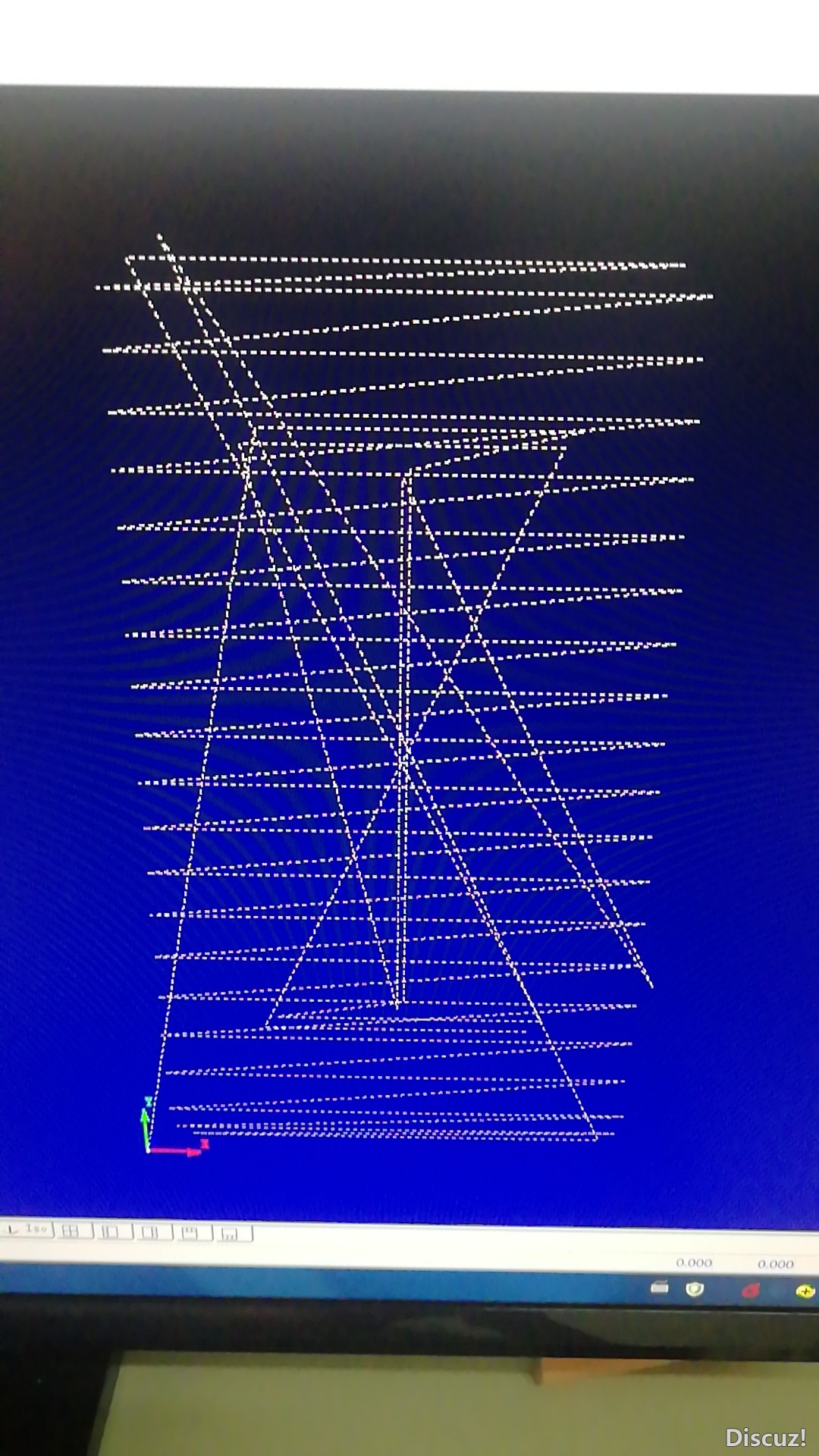

这有现在的
这有现在的
(defun c:ttaa(/ e e1 e2 f n m p pp p0 pt y x r r0)
  (setq f (open "C:\\Users\\Administrator\\Desktop\\dk.nc" "w"))
  (setq s (ssget))
  (setq n (sslength s) m 0 pp '())
  (repeat n
    (setq e (ssname s m) m (1+ m))
    (setq e1 (entget e))
    (setq e2 (cdr(assoc 0 e1)))
    (if (= e2 "CIRCLE")
        (progn
          (setq pt (cdr (assoc 10 e1)))
          (setq  y (car pt) x (cadr pt))
         (setq  r (cdr (assoc 40 e1)))
          (setq pp (cons (list r y x) pp))
    (setq pp (sort_pList pp))
    (setq m 0 r0 nil)
  (repeat (length pp)
    (setq p (nth m pp) m (1+ m))
    (setq r (car p))
    (setq p0 (strcat "N" (rtos m 2 0) "X" (rtos (cadr p) 2 2) "Y" (rtos (caddr p) 2 2)"Z10."))
    (if (/= r r0)
      (progn
          (write-line (strcat "D" (rtos r 2 2)) f)
          (write-line p0 f)
          (setq r0 r)
      (progn
            (write-line p0 f)
   (close f)
    (princ)
;;;对点表按xyz排序
(defun sort_pList (plist / fp pt)
  (setq plist (vl-sort plist
         '(lambda (p1 p2)
          (cond ((< (car p1) (car p2)) T)
          ((and (= (car p1) (car p2))
          (> (caddr p1) (caddr p2))
     T
          (= (caddr p1) (caddr p2))
          (< (cadr p1) (cadr p2))
     T
    (T nil)
这是现在的
这是现在的
想改成按红色线排队
想改成按红色线排队
