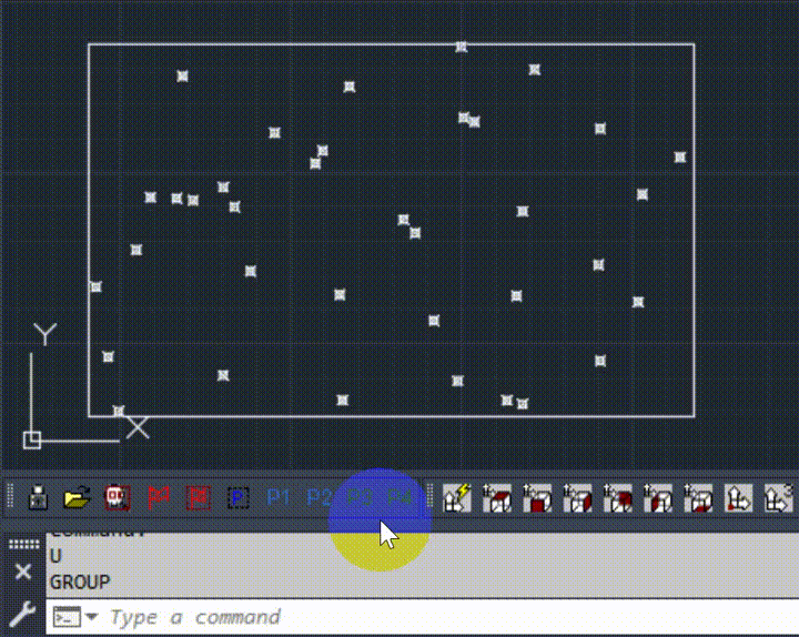

  1. (defun c:tt ()
  2.   (and (setq ss        (xdrx-ssget
  3.                   (xdrx-string-multilanguage
  4.                     "\n选择点对象<退出>:"
  5.                     "\nSelect point object <exit>:"
  6.                   )
  7.                   '((0 . "point"))
  8.                 )
  9.        )
  10.        (setq pl        (xdrx-entsel
  11.                   (xdrx-string-multilanguage
  12.                     "\n选择外边界<退出>:"
  13.                     "\nSelect outer boundary <exit>:"
  14.                   )
  15.                   '((-4 . "<and")
  16.                     (0 . "*polyline")
  17.                     (-4 . "&=")
  18.                     (70 . 1)
  19.                     (-4 . "and>")
  20.                    )
  21.                 )
  22.        )
  23.        (xdrx-points->voronoi ss pl t)
  24.   )
  25.   (princ)
  26. )

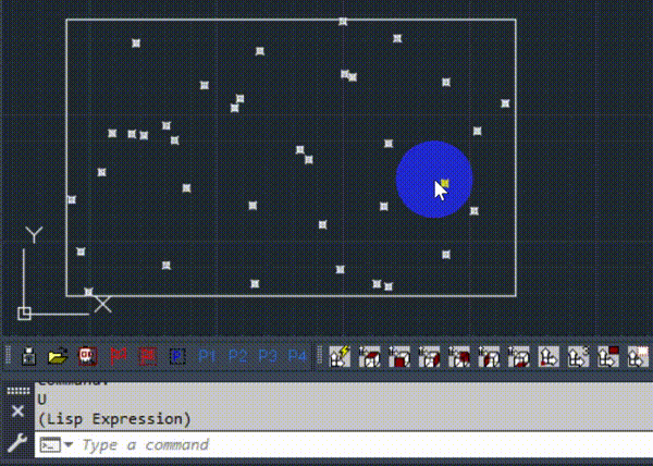

  1. (defun c:tt1 ()
  2.   (if (and (setq ss (xdrx-ssget
  4.                         "\n选择点对象<退出>:"
  6.                       )
  7.                       '((0 . "point"))
  8.                     )
  9.            )
  12.                         "\n选择外边界<退出>:"
  14.                       )
  15.                       '((-4 . "<and")
  17.                         (-4 . "&=")
  18.                         (70 . 1)
  19.                         (-4 . "and>")
  20.                        )
  21.                     )
  22.            )
  23.            (setq polygon (xdrx-points->voronoi ss pl))
  24.       )
  25.     (progn
  26.       (xdrx-begin)
  27.       (xdrx-entity-delete ss)
  28.       (xdrx-sysvar-push '("pdmode" 99 "pdsize" 10))
  29.       (foreach m polygon
  30.         (setq bound (car m)
  31.               pnt   (cadr m)
  32.               clr   (xdrx-math-rand 0 100)
  33.         )
  34.         (xdrx-point-make pnt)
  35.         (xdrx-setpropertyvalue (entlast) "color" clr)
  36.         (xdrx-polyline-make bound t)
  37.         (xdrx-setpropertyvalue (entlast) "color" clr)
  38.       )
  39.       (xdrx-sysvar-pop)
  40.       (xdrx-end)
  41.     )
  42.   )
  43.   (princ)
  44. )
