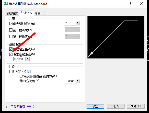

修改多重引线MLEADER样式里面的 基线距离 开关
(defun MLeaderLandingDistance ( sty flg / dic )
    (and (setq dic (dictsearch (namedobjdict) "acad_mleaderstyle"))
         (setq dic (dictsearch (cdr (assoc -1 dic)) sty))
         (entmod (subst (cons 43 ((if flg + -) (abs (cdr (assoc 43 dic))))) (assoc 43 dic) dic))
用法:
(MLeaderLandingDistance (getvar 'cmleaderstyle) t)
(MLeaderLandingDistance (getvar 'cmleaderstyle) nil)
