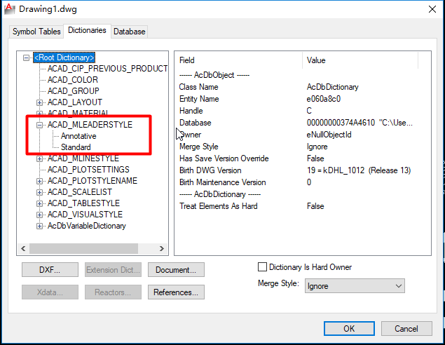

发表于 2018-1-17 13:24:25 | 显示全部楼层
在词典里面

发表于 2018-1-17 13:31:41 | 显示全部楼层
命令: (setq newdictlist (dictsearch (namedobjdict) "acad_mleaderstyle"))
((-1 . <图元名: 7ff7e0605150>) (0 . "DICTIONARY") (5 . "12D") (102 .
"{ACAD_REACTORS") (330 . <图元名: 7ff7e06038c0>) (102 . "}") (330 . <图元名:
7ff7e06038c0>) (100 . "AcDbDictionary") (280 . 0) (281 . 1) (3 . "Annotative")
(350 . <图元名: 7ff7e0605230>) (3 . "Standard") (350 . <图元名: 7ff7e0605160>))
 楼主| 发表于 2018-1-17 13:47:53 | 显示全部楼层
ok,谢谢两位版主,搞定。。
 楼主| 发表于 2018-1-17 13:48:55 | 显示全部楼层
  1.    (setq Acad (vlax-get-acad-object)
  2.           Adoc (vla-get-ActiveDocument Acad)
  3.            dicts (vla-get-dictionaries Adoc)
  4.     AMleaderStyle (vla-item dicts "ACAD_MleaderStyle")
  5.    )
  6.    (setq mlst(vla-addobject AMleaderStyle "NewStyle" "AcDbMleaderStyle"))
