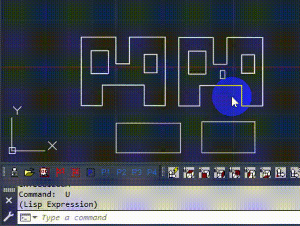

[每日一码] 快速生成直骨架
发表于 2025-1-9 18:14:58 | 显示全部楼层 |阅读模式
  1. (defun c:tt ()
  2.   (and (setq ss (xdrx-ssget
  3.                       (xdrx-string-multilanguage
  4.                         "\n选择带洞多边形<退出>:"
  5.                         "\nSelect polygon with holes <exit>:"
  6.                       )
  7.                       '((-4 . "<and")
  8.                         (0 . "*polyline")
  9.                         (-4 . "&=")
  10.                         (70 . 1)
  11.                         (-4 . "and>")
  12.                        )
  13.                     )
  14.            )
  15.            (xdrx_polygon_get_interior_skeleton ss t t)
  16.       )
  17.   (princ)
  18. )
